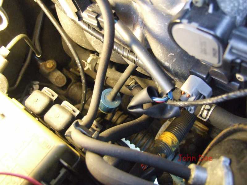

If you look under the battery, there is a birdsnest of rubber pipes and the two vacuum valves. There is a round switch with two wires on attached to one of the pipes near the valves. Join the wires together.
Then there is a pipe leading from the manifold to this birdsnest. Blank it off at the manifold with a rubber cap.
One look under the battery almost put me off. Oh for tiny hands.

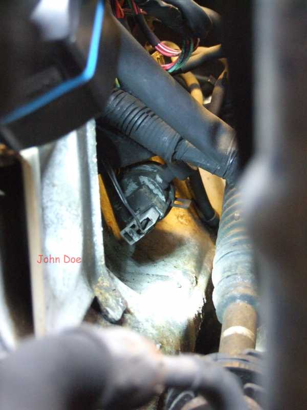

I removed the vac tank for better access. Here is the plug on the switch viewed from the radiator.

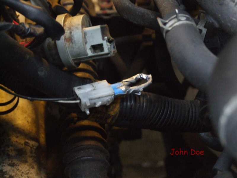

The round switch unit pulls out of a spring clip for better access but not much . I wanted to remove the wiring plug from the switch rather than cut the wires and that was a nightmare. Eventually I kinda broke the plug's clip as you can maybe see.

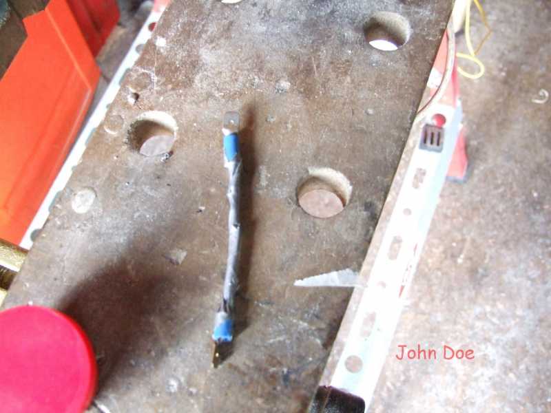

Next I made a patch lead.
Which fits like this.
Then all I had to do was whip off the vac tube going from the round switch to the manifold and replace it with a plugged bit of tube. I was going to use a ball bearing but that's another story. :laugh:
Finally fitted a decent blanking plug.
