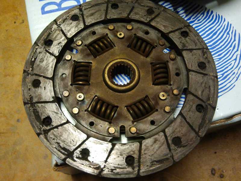

I am half way through mine (clutch now removed) and I am very new to the mechanics game and upto about 4hours now. I did follow Martins guide and removed the transfer box, exhaust front pipe, front 2 propshafts and eased back starter the motor (dont know if all that is strictly necessary though :dry: )
On a slightly different note I burnt the clutch out offroading and it stunk! Infact I just got it home. The confusing thing is that when I removed it I expected the friction plate to be down to the rivets, but it wasn't :S
It was very shiny though and had some deep gouges in it. Does this sound right.
Please see pics: any advice appreciated guys.
