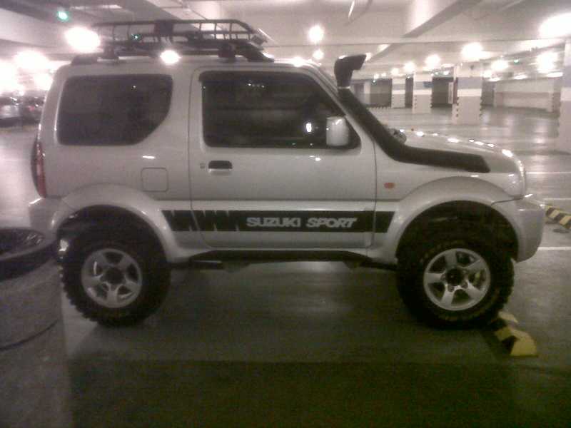

so when i went from a 3" lift to a ora 4.5" lift it put my steering wheel out with the old panard rod wich i had to cut off when i fitted the ora rod and ajusted the axle back into line so did the steering wheel line back up

With a longer panhard rod to push the axle back central, the axle is simply lower down, then the distance from the steering box to the hub knuckle joint is longer, so the drag link has to be longer to keep the wheels straight. You could well be right, the difference may be very small at the wheel, but there must still be some.
However, the steering wheel is fitted with the 'box central, and should not be disturbed, any adjustment should be at the drag link, to keep the 'box central between the lockstops in the straight ahead position. (I believe the lockstops are in the 'box on a jimny, not at the hubs like on a Landrover)

thanks! looks like im gonna have it sorted out by my local alignment shop. that must be why my steering turns are unequal.
