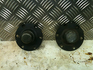

right can anybody tell me what hubs i have on my jimny thay dont look like the normal vac hubs but thay are not manual hubs eather the vac pipes have been cut and caped but the 4WD all works and these permataly locked ill try and get some pics tomorrow

Sounds like old SJ locked hubs.

Replied by markyp2000 on topic front hubs
do thay look like this

Replied by mudman on topic front hubs
thats the ones mark!! are these any good on a jinmy?? pros and cons??

Replied by Dave cc on topic front hubs
That because they are SJ parts that you have if you do not have free wheeling hubs hence that is why they are locked all the time.
Im afraid with those its locked no free wheeling
You may get a bit of drag when in 2wd but I spose thay are better than the vacuum hubs and is saves you getting out and locking the manual ones do thay have spacers behind them if not the shafts/cv joint may have been cut to make them fit its up to you if u wanna keep them also the hub nut may have been but down if there are no spacers
