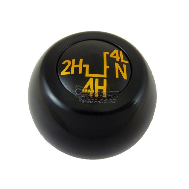

I am having difficulty working out what should be happening with my driven wheels. The lobster appears to have a J style layout. The front prop is connected to an SJ axle with fixed (not manual locking) hubs via an ARB locking diff. The rear prop drives the rear Jimny axle via another ARB locking diff.
What should be happening under each setting and how am I best to test everything out to make sure it is all working correctly.

.....4l
2h...n
......4h
Is the patten so if you disconnect the output flanges you will get drive in 4h and 4l to both flanges and in 2h just to the rear one
2h...n
......4h
