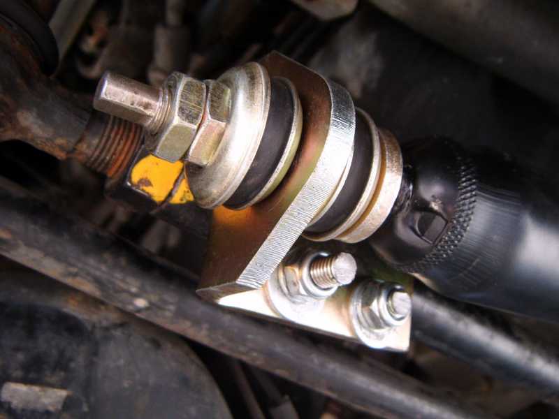

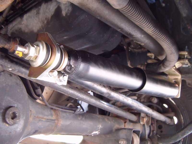

Are you doing up the nuts on the steering damper brackets to tight so the rubbers are locking up on the bracket fitted to steering rod.
This is some photos of my damper hope this helps.
