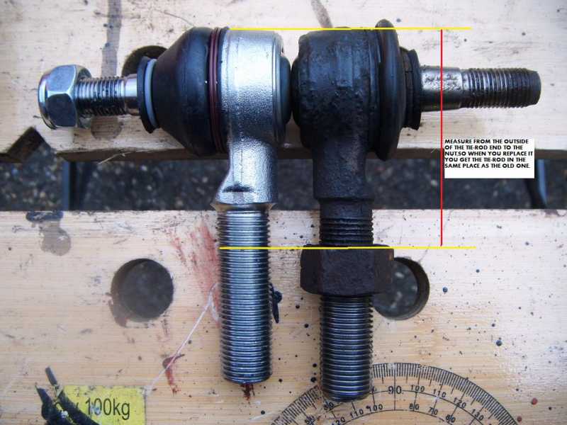

A little tip Scott.
As you can see from the photo of the tie-rod ends, they have two different length threads so you will need to measure as in the photo, from the outside of the tie-rod end to the locking nut, so it fit in the same place as the old one on the steering bar.
Hope this helps.

Replied by markyp2000 on topic Track Rod End Replacement
good tip but personaly id mesure from the center of the ball joint as the diameter of the joint my be bigger/smaller but the distance from the center wont change
