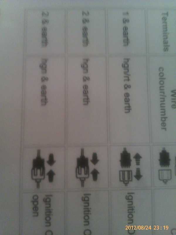

- markyp2000
24 Aug 2012 22:23 #46726
by markyp2000
Replied by markyp2000 on topic Throttle Position Sensor - TPS - M13A

- markyp2000
28 Aug 2012 23:28 #47011
by markyp2000
if you check the out put like i posted up and you get the same sort of result then i say the sensor is ok
