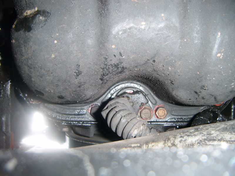

j999pre wrote: The spanish hard tops sometimes have the crankshaft sensor middle of the front of the sump from underneath close to the crank pulley. Check for a wire running to it.

its the crank sensor we are looking for on a 16 valve sohc we have found a allal key bolt above the oil filter with a plaggy cap with wot looks like a single wire to it

sorry an allen key bolt. :silly:
didnt think the spanish made hard tops only soft
Sorry meant soft tops
Grey pick up Jimny
