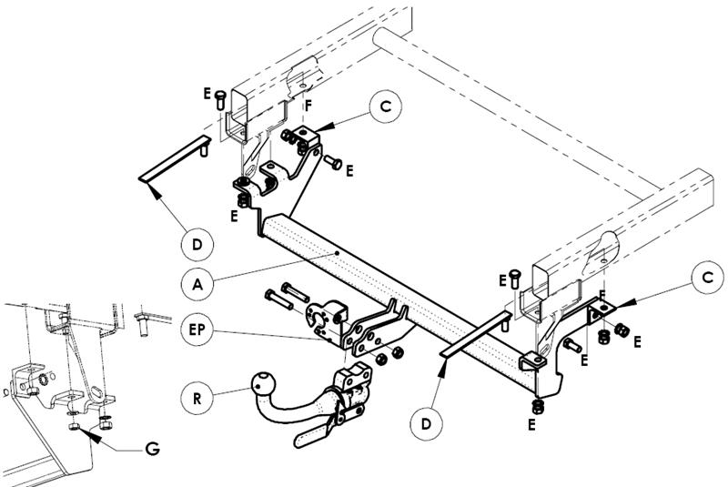

Would any kind soul like to post pics of the tow bar fitment mounts/points on the chassis. I want to make a carry rack for farm use but would like to mount it as a tow bar would to use the strongest points. Buying a bar is a bit daft as much of it will be chopped.

I'd keep an eye on ebay and pick yourself up a cheap towbar and mod it.
The mounting points are just some 12-15mm holes in the main chassis rail.
The exhaust side is more complicated due to the tail pipe.

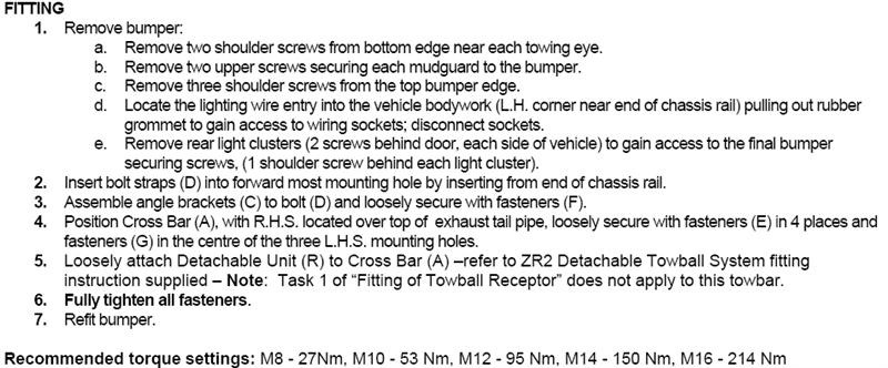

Replied by Fearghal Murphy on topic Re: Tow bar fitment
the diagram above is the setup on my jimny. Was there when i bought it, and i love it very practical ! I can just remove the actual tow bar n ball with the pull of a lever and thats that ! Very handy !
