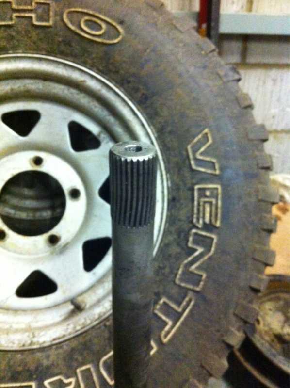

Advice on repairing this
- ianR
21 May 2012 19:35 #40871
by ianR
Advice on repairing this was created by ianR
21 May 2012 19:46 #40872

Replied by mcjimny on topic Re: Advice on repairing this
Looks like an axle strip down and weld on some new beefier jobs and some bracing. Is this not similar to martins problem?

Replied by kirkynut on topic Re: Advice on repairing this
It appears similar to Martin's problem and I believe from what Martin wrote in his blog that Rob Butler at Off Road Armoury had new brackets made up and has saved the CNC work on them to be able to get more made up.
I'd suggest a call to Rob Butler to see what he can do for you by way of sending you new brackets, then you need to get it to a good welder who can weld it on in the right place - maybe in a position that corrects castor if you need it.

Replied by ianR on topic Advice on repairing this
25 May 2012 19:22 #41158
by facade
Replied by facade on topic Re: Advice on repairing this
The shaft is twisted, replace it before it shears.

by ianR
Replied by ianR on topic Re: Advice on repairing this
Oh well, least its all apart.
Cheers for confirming it.
