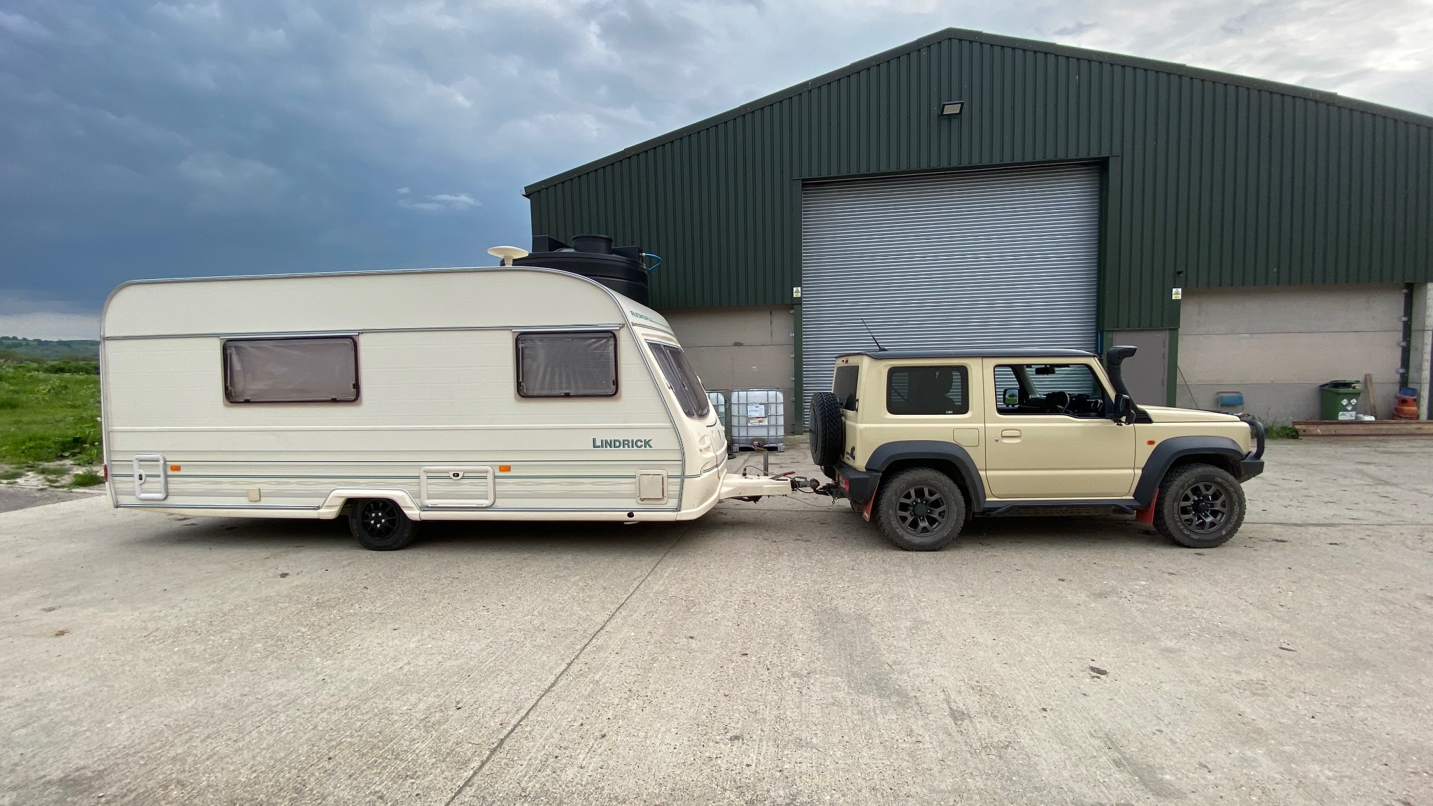

However, before the stock suspension went wobbly I did tow my 1200kg caravan with the Jimny from Bedfordshire to mid Wales and back. It lacked a little grunt on the steeper hills, but felt rock solid cruising at 60mph on the dual carriage-ways.
CONCLUSION: I think your stock suspension is knackered (shocks mostly), despite it being quite new and low miles!
