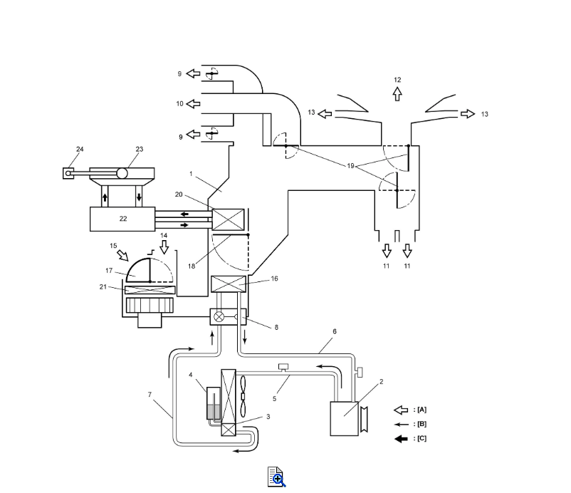

Control cable 1 in the picture below controls the main three way air door
It appears as item 19 in the picture below. It has a 3 way operation
Exit 9 are the ball vents on the dashboard ends
Exit 10 is the central vents
Exit 11 is the foot vents
Exit 13 are the side demister vents
Exit 12 is the windscreen
