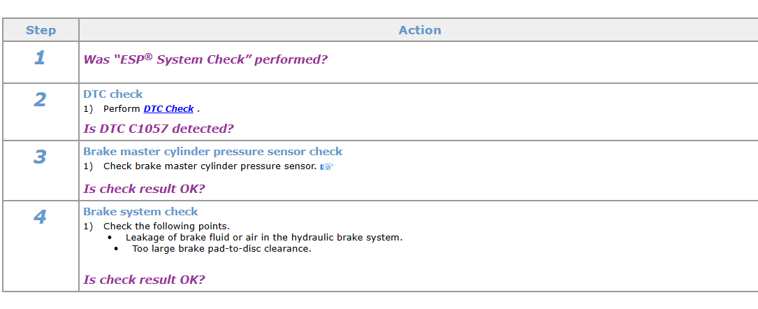

Whatcha. Bellerophon my 2024 van is giving me a persistent c1028 code which is brake pressure sensor in the abs esp unit. Symptoms being no hill hold, and prolonged pressure on the pedal say in traffic at a down hill junction results in much beeping and service esp system on an orange dash. Before I ring the dealer for a warranty is there anything simple to check like a connector or something to jiggle or undo and redo? Nothing has obviously exploded under the bonnet on a cursory exam and it has a firm pedal.

The only "easy" check is the last one. The others require a pressure check in the system
C1057 is low voltage detected by the ESP unit, so this is a voltage check on the ESP unit plug. This would be a wiring fault or charging failure
Replied by mlines on topic Persistent c1028 code
