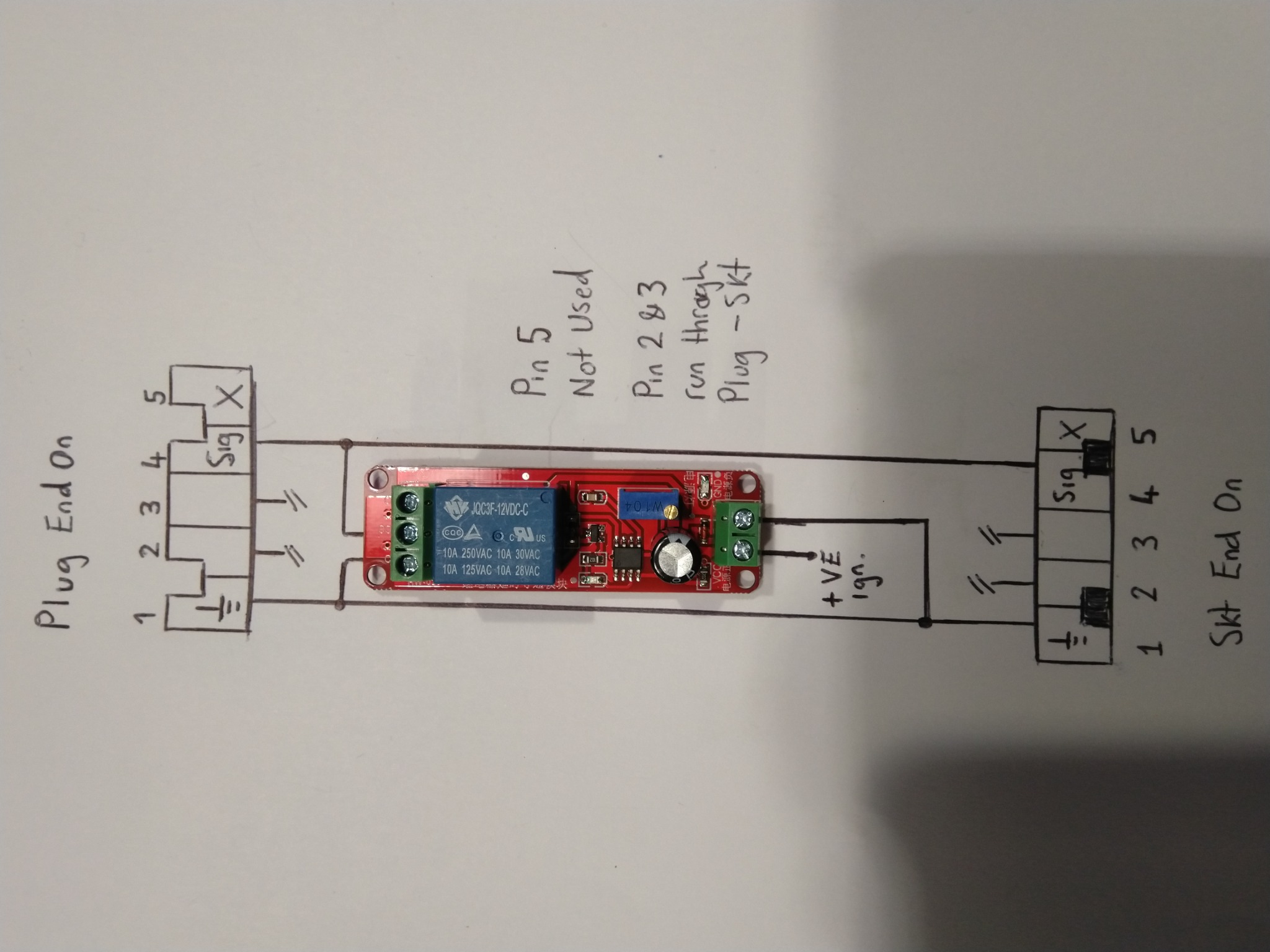

When pressing the dash button to turn the feature off we are temporarily connecting the signal wire (plug pin 4) to the earth wire (pin 1). A period of approx 6 seconds is required, hence the need for a timer circuit. By placing another timer controlled switch in parallel to the dash switch - the board relay, we can automate the button press and at the same time keep the dash button.
The first photo shows the timer board. Connecting the board to power brings on the red LED and the timer commences. The time is defined by the blue potentiometer brass screw from 0 to 10 seconds, increased by turning the screw clockwise. Once the timer has expired a relay click can be heard and the blue LED aluminates. This can be played with on the bench with a 12 volt source to obtain approx. 7 sec delay.
We need to use the NC contacts on the relay so that the circuit is made with ignition on and then opened once the timer expires thus automatically turning the function off upon ignition on.
Second photo shows the circuit and the connector pin outs. Pin 5 is not used, pins 2 and 3 are wired through from plug to socket and supply the dimmable light supply for the dash switch. The only issue left is to pick up an ignition switched +12v supply to the module via a piggy back fuse wire from the fuse box.
The most difficult bit is wiring the pins into the plug and socket (especially if you are starting to need reading glasses!)
