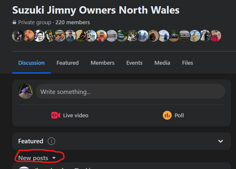

Thanks for your reply. Ive looked on the jimny owners north wales facebook group and the complete topic has been deleted. I dont have the information you mention and i have no idea why the entire thing has been removed......
