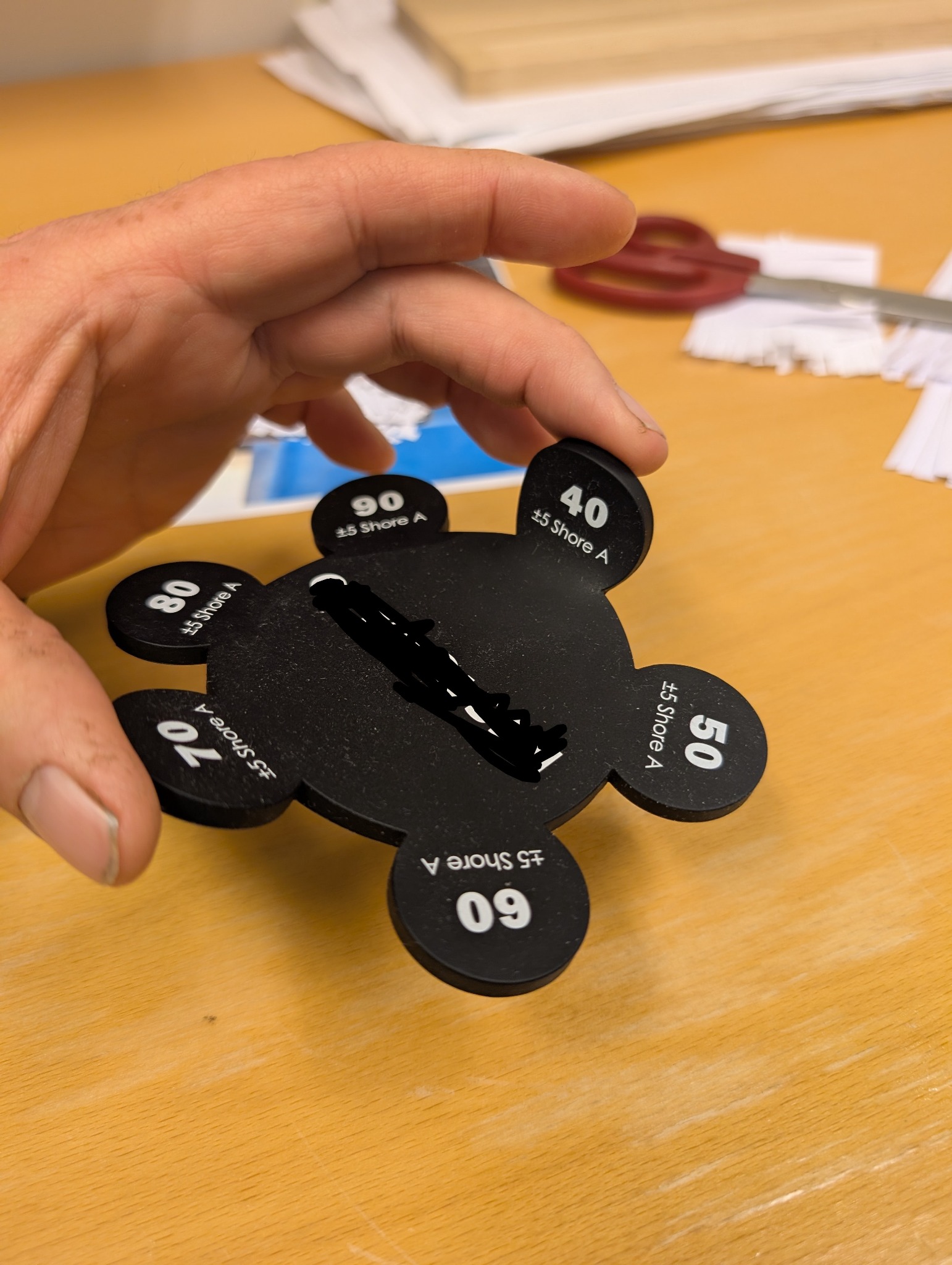

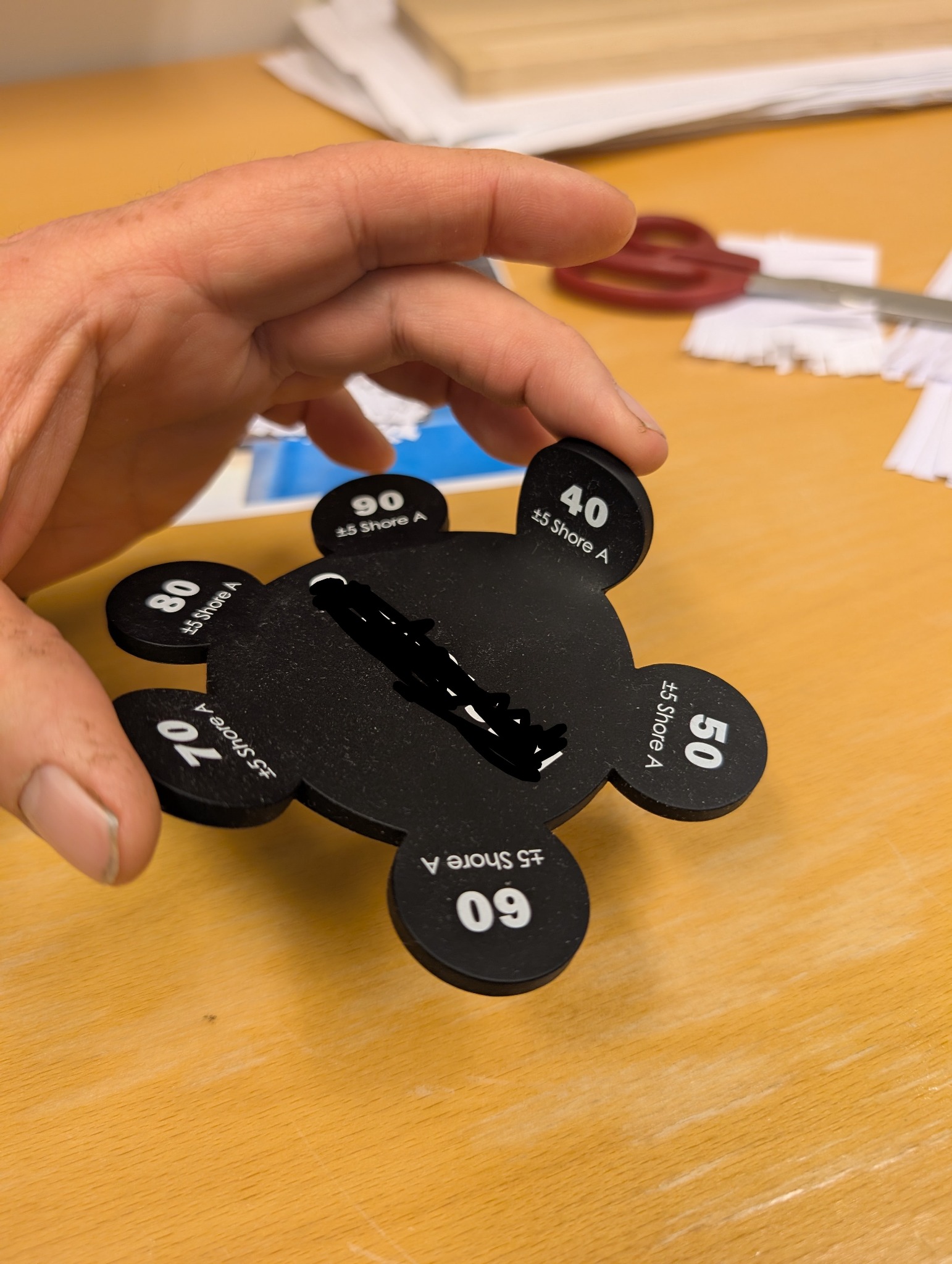

I f you can choose the Shore hardness I guess the original rubber is 70 shore or most likely around that. For any significant noticable difference in stiffness hardness you must up at 90 I guess or about 20 shore.
We have this test piece at work.
My bad experience are with the cheap ones on the SJ with many bushings in the ends of the leaf springs and shackles. 6 bushing halves on each spring.
I like soft and flexy so for me there is no point in it.
