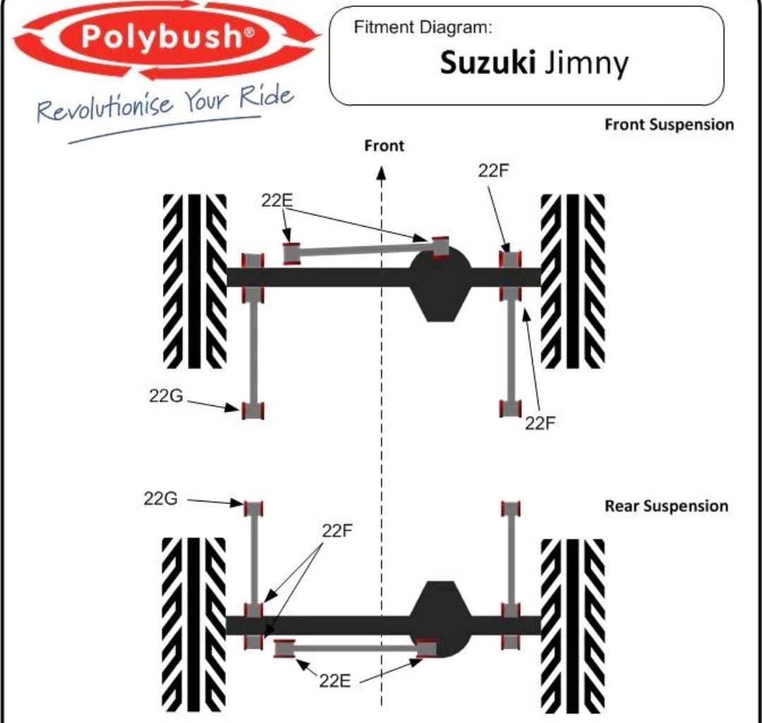

I have original polybush orange ones
No complaints from me
I changed front panhard bushes after 6 years
They showed very little wear and deformation
No ovaling of mounts
By far not the cheapest and would I fit again absolutely yes.
As for handling it would be hard to say from my perspective.
Never had front anti rollbar
Always had mud tyres
Always been lifted
Yes drove it like I'd stolen it a fair few times and seemed predictable
Fitted in all radius arms and panhard rods
Always been lifted
