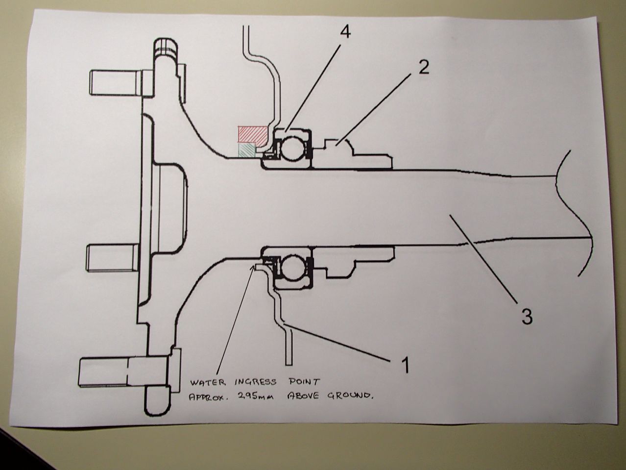

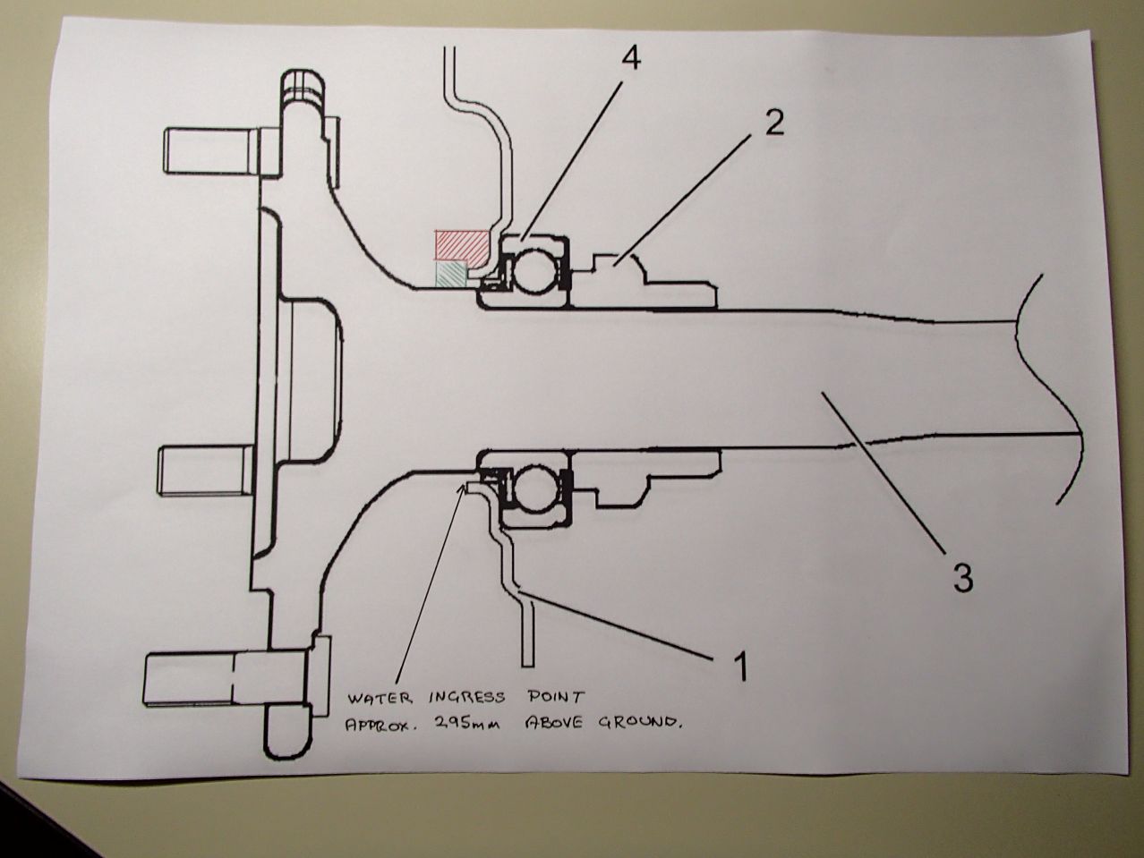

10 Oct 2025 16:47 - 10 Oct 2025 16:48 #262254
by Roger Fairclough
Good afternoon gentleman.
I carried out this modification to my SJ413 and Vivs SJ410 some 30 years ago. The idea was to stop the ingress of water ( specifically dirty ) to protect the rear wheel bearings from corrosion. Both SJs were used for RTV trials and green lane trips and bearing failure was a common occurrence. The shaft needs machining so that the twin lipped seal (shown in green) runs on a suitable polished steel surface. The seal housing I made from brass, machined on my own lathe and can be mounted to the back plate either with solder ( I kid you not) or countersunk machine screw. I also fitted a grease nipple onto the housing to enable me to pump grease between the seal and the bearing. If you remove the outer bearing seal this grease will also replenish the bearing grease.
Yes it worked and bearing replacement due to corrosion was a thing of the past..
Roger
Replied by Roger Fairclough on topic Rear bearing eater
Roger
Last edit: 10 Oct 2025 16:48 by Roger Fairclough.
