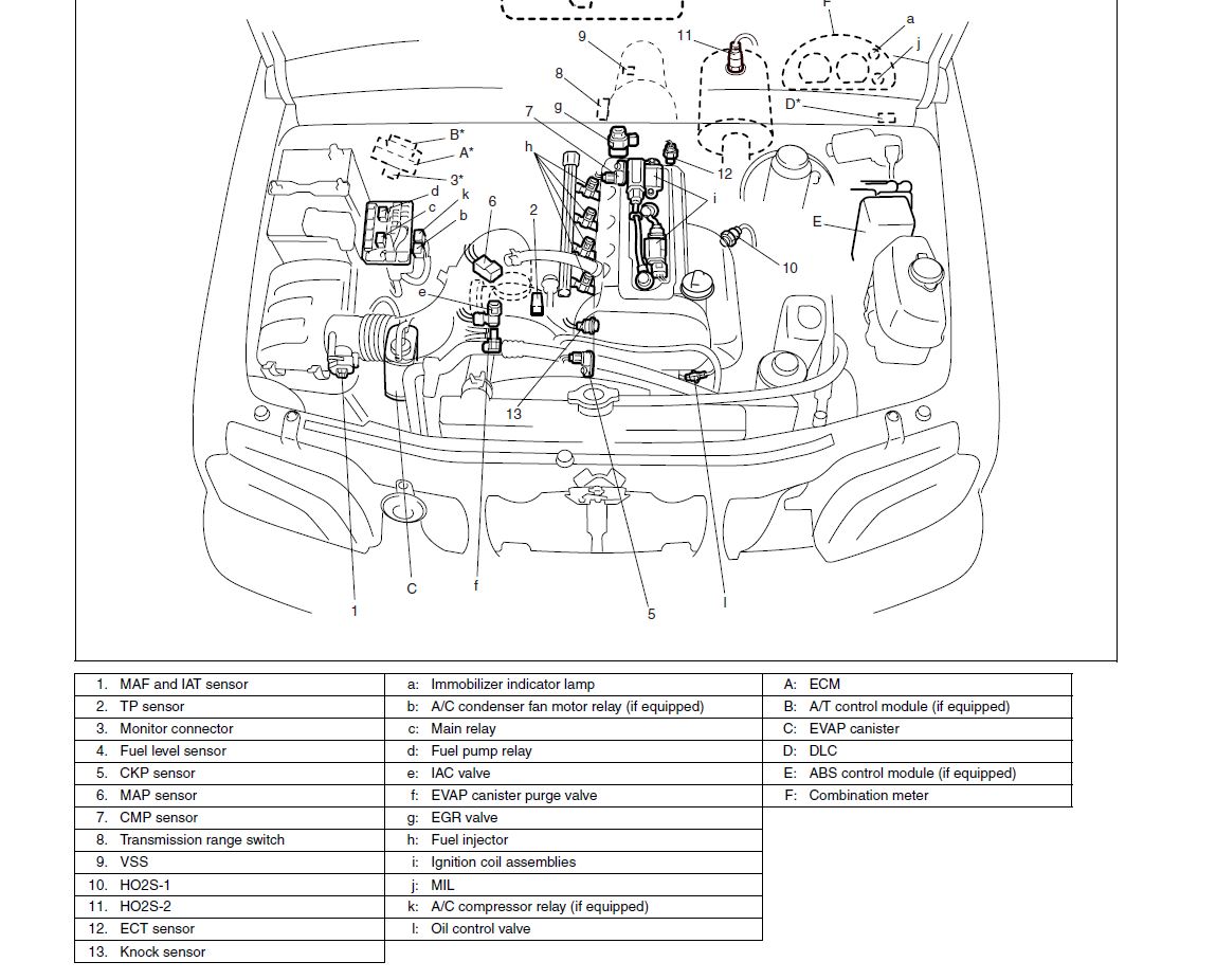

No personal experience with them, but looking at the FSM, some of the G3s possibly the ones with VVT, do have a MAF sensor.
The expected flow rate "at specified idle speed with no load after warming up" is 1~4 g/s
Replied by fordem on topic Mass airflow sensor
The Gen3 M13 and g13 don't have MAF sensors, only MAP.

All Jimnys (at least in NZ) that I have seen after 2005ish with a 1.3 are VVT.
OP has same year as mine so will have VVT and a MAF sensor I presume.
Replied by Hughes on topic Mass airflow sensor
Yep M13A VVT Engine is what I have.

I stand corrected, so they do!
I had checked the 99501_81A10_01E manual, but didn't spot that I was looking at 6.1 for non-vvt rather than 6.3 for VVT engines.
My Gen3 was M13 non-vvt.
I wonder why they went to MAF, and then back to MAP for the Gen4.......
