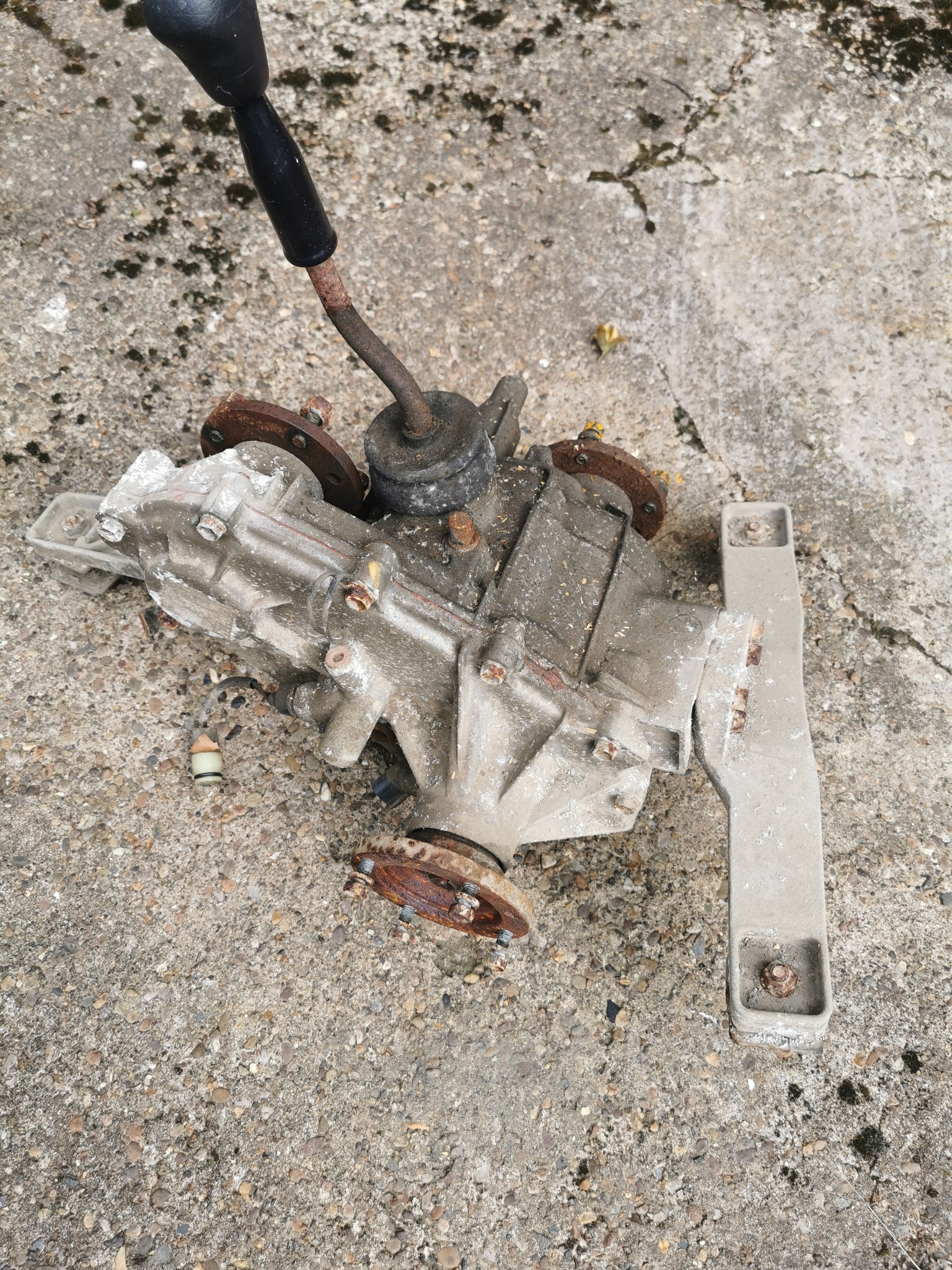

You say you've got through a few transfer cases- what is the typical failure mode? And after how many miles?
I'm towing around 1,200kg most days with a 1.6 Jimny and I don't exactly go easy on it. The original transfer case chain stretched and started skipping at just over 100,000 miles (25,000 miles into my ownership). I've since done another 25,000 miles with another used transfer case, so that now has just under 100,000 miles on it and is still holding out OK.
