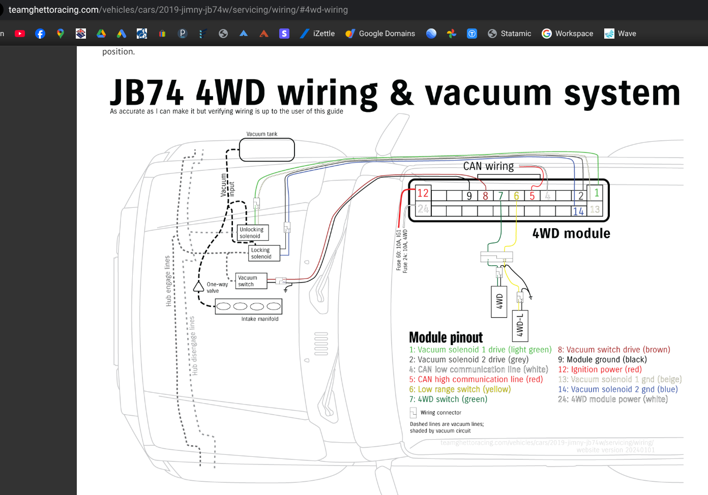

Rather than using manual hubs for 2 low (crude, tiresome) I'd look at how the vehicle detects you have selected 4wd and interrupt that signal. On early gen3s this is as simple as unplugging the wire to the 4wd switch on the transfer case and instead running those 2 wires to a switch inside the car. Now you have completely manual control of the vacuum hubs without leaving the car.
With the gen4s also having a stick-operated transfer case there must be a similar hack that lets you manually move the stick to wherever you want without the car knowing you've done it, and at the same time manually controlling the bit that tells the car where the stick is. Anyone got a gen4 wiring diagram?

Found this!
So you have 2 wires that matter. One that tells the car it's in 4wd (7) and another for low range (6). Find these wires, redirect them to some switches and have a play. Both go to earth, so it looks to me like there is a very simple solution to getting much more control over the 4wd system.
