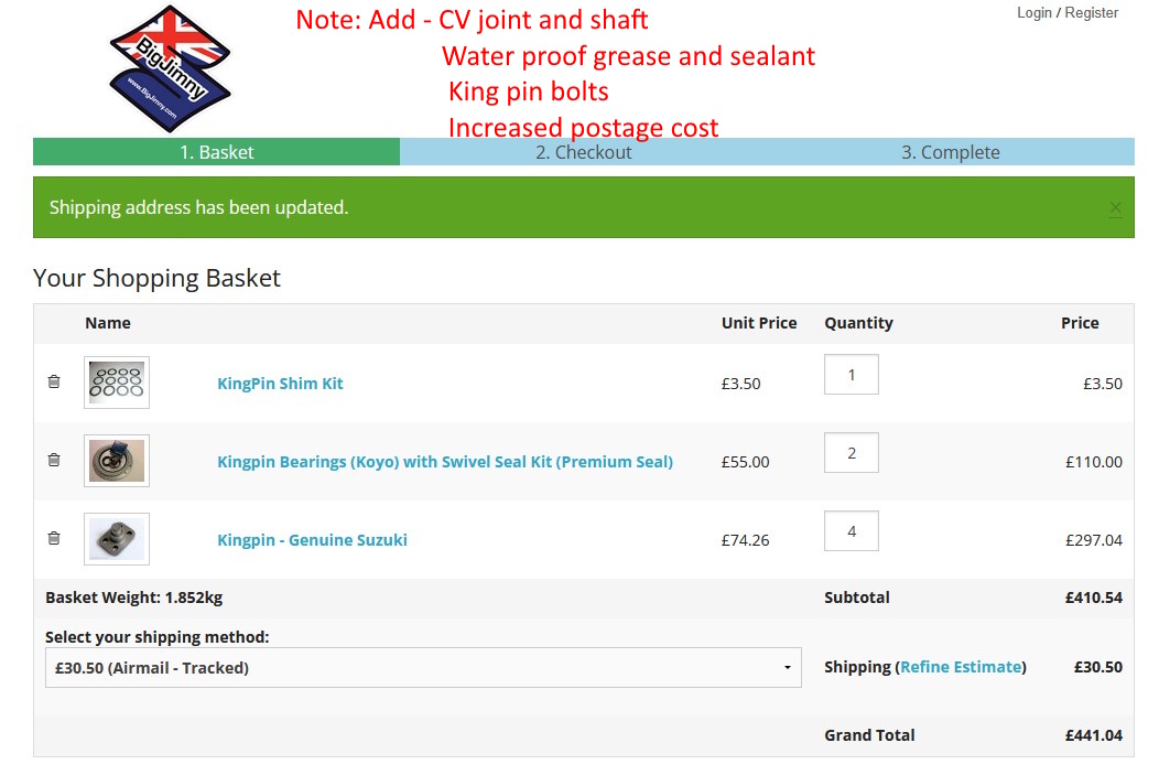

11 Apr 2025 01:34 - 11 Apr 2025 02:11 #260098
by Wadjela
$239 R CV joint and shaft (includes $37 postage)
$50 Grease/ silica sealant
$500 labour (Grandson rates)
The following is an interesting comparison:
All prices AUD
Tried to get local workshops to give quote but none of them wanted the job, Local Suzuki dealer considered the vehicle too old for them to work on (thanks Suzuki).
Replied by Wadjela on topic 2WD with High and Low range?
$571 - Kingpins/bearings/shims and seals from Jimnybits (includes $100 postage to Aus).1300 bucks? For what, a new axle? Genuine parts at the main dealer? Seems very expensive.
All prices AUD
Last edit: 11 Apr 2025 02:11 by Wadjela.

Replied by Lambert on topic 2WD with High and Low range?
For future reference it's highly unlikely that you ever need the actual kingpins unless you have allowed it to go for a very long time without attention. Seals, bearings and shaft fair enough. Charging actual close family labour rates above zero, not in my world. Charging mates and civilians fair enough but not actual family
