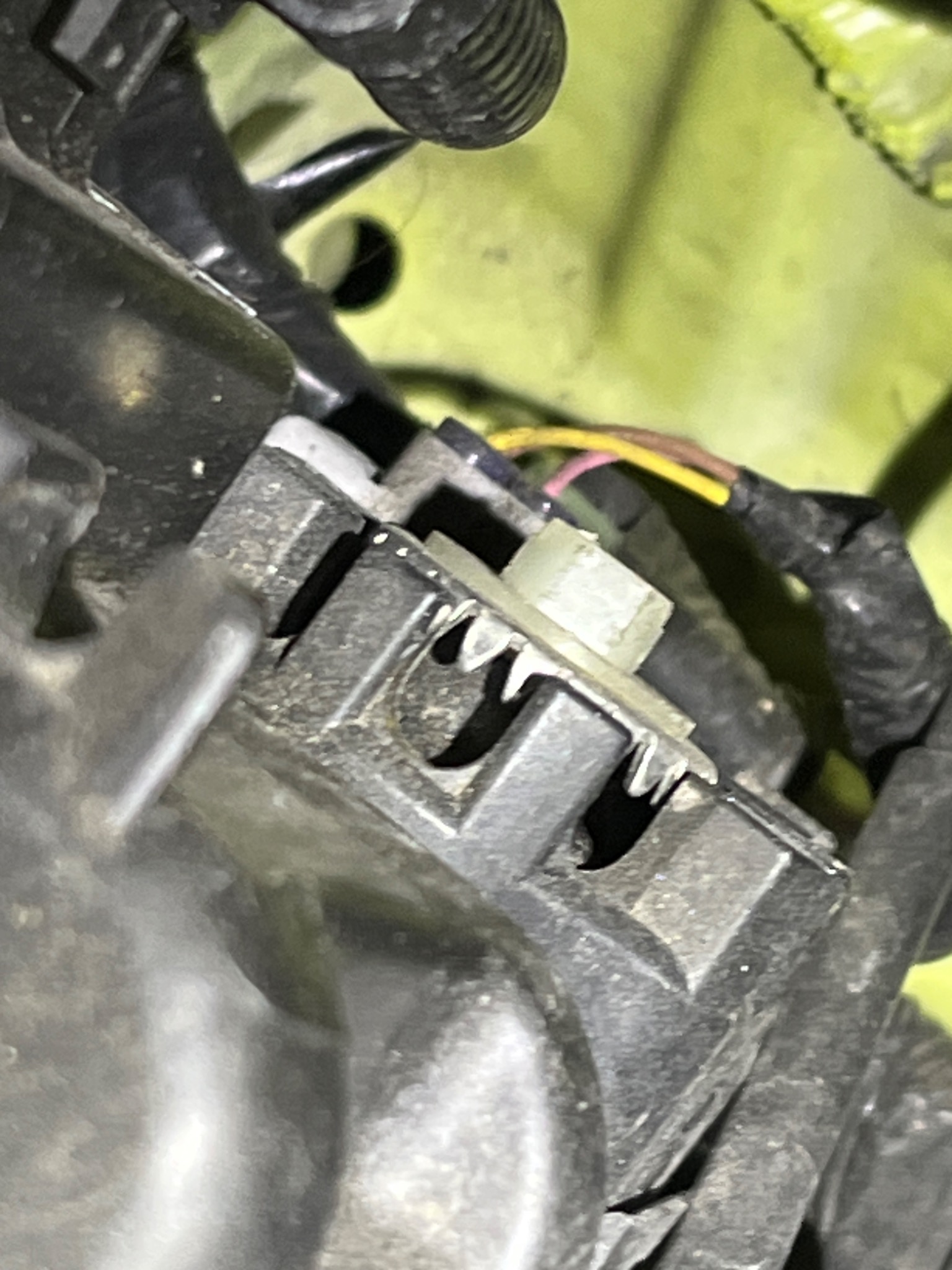

Replied by mlines on topic Headlights adjusting tool
Small socket on the head , 8mm?
You can see me use a socket in this video on the dip unit which achieved the same thing

14 Mar 2025 22:33 #259803
Replied by DrRobin on topic Headlights adjusting tool
I did mine in both vertical and horizontal using a socket, no problems at all.
I used a wall to adjust them which worked fine (vertical is perfect and both dip beams Z beam overlap at the correct distance, but in the fog last weekend they are slightly out to the left so will make another adjustment.
Before I started I got flashed at all of the time, now no one flashes at me and they are still good enough for the speed of the vehicle.

- Posts: 977
- Thank you received: 81
14 Mar 2025 23:32 #259804
by lightning
Replied by lightning on topic Headlights adjusting tool
Can you tell me which is the vertical adjustment and which is the horizontal?
15 Mar 2025 07:32 #259805
If you do it on the dipping motor you get vertical only
