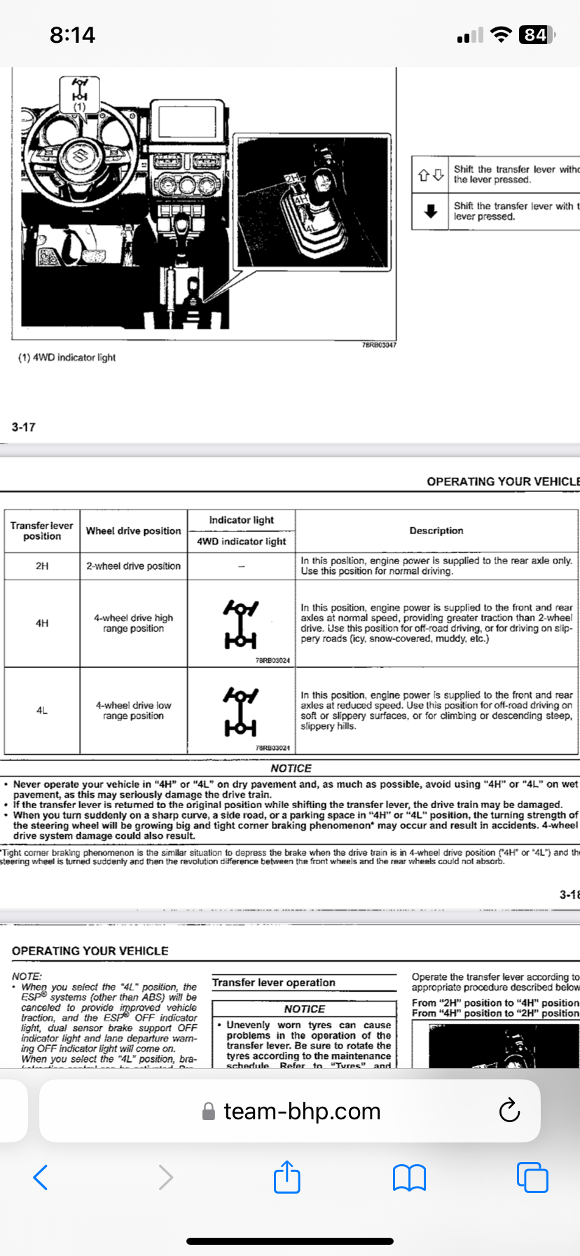

Apologies, however I thought/felt that was a polite reply, was meant more in jest…. Maybe it needed an emoji??
About 40 sec of effort on Google:
You can download the manual as a pdf, so should help the op with the specifics of the 4wd system as well as other aspects of the car.
