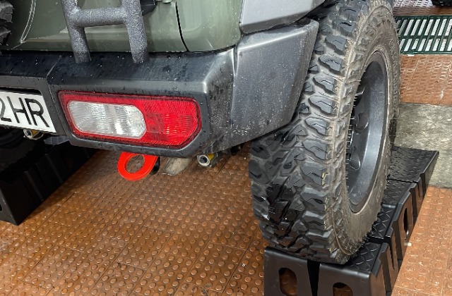

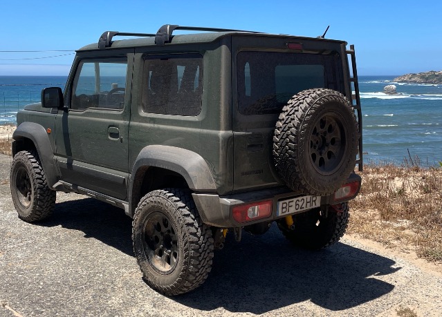

Rear bumper is a Japanese High Bridge 1st. It's shorter, allows the original tail lights to be retained, but contours are like the flairs.
All my mods are to be not seen. Just subtle stuff. Hence the wheels etc.

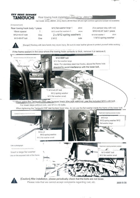

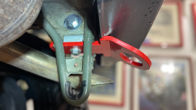

Tow point is Taniguchi (Nippon too).
