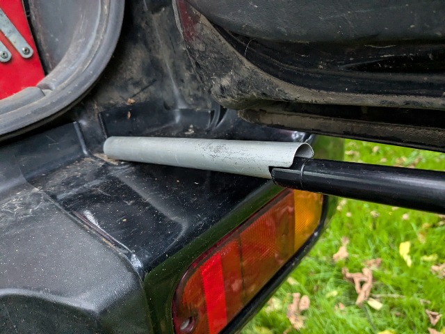

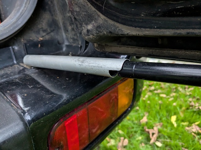

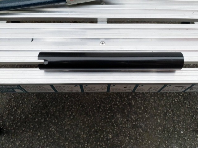

1) Automatic rear door stay I made from 25mm plastic pipe, cut at one end to clip onto the ball mount the gas strut is fastened to. I had seen ones you can buy but they are to put on and remove as required. This stay on even with the door closed.
The one in the video clip is the MK2, I left an extended length of pipe on the underside to make it easier to just flick up into the unlock position.
Strut Lock
2) A simple hook on/off bracket, (can't find it online now) but basically a length of flat bar bent 900 upwards at each end, with an angled slot in each end. It simply hooks over the strut rod and remove to close the door.
Strut Lock
