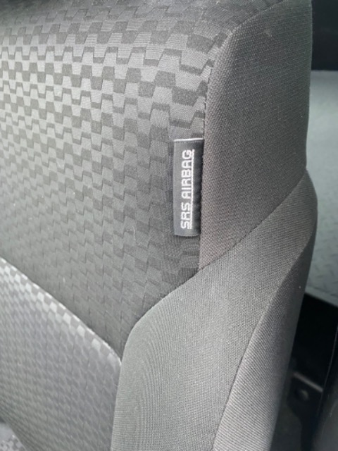

My 2020 SZ5 is fitted as standard with front seat airbags, there is a tag on them, see photo. I am not sure about the LCV, it might have been an option.No airbags on the seats of the 2-door version, at least here in the EU.
