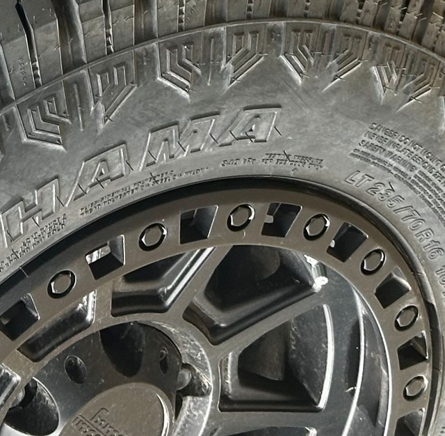

I think that is more likely an artefact of those wheels being much wider than a standard jimny wheel hence such a relatively wide tyre not looking very pinched at the bead, they could easily be a 7j or even an 8j 16 so wouldn't necessarily need a spacer to look wide relative to the bodywork. But again without looking for stamped information on the inside of the wheel that is speculation.
Replied by Lambert on topic Jimny LCV - Wheel/Tyre size question...
The rim edge certainly looks as if it is in line vertically with the wheel trim and that means it is approx. 25 mm further out than standard. I would suggest the car is fitted with wheel spacers and that would probably be enough to allow the fitting of those hub covers.
Roger

The more I look at this listing the more questions I have, 1900 miles in under 2 years? Very big red flag for me. OK it might be a 3rd car fair enough or is it that they have put a load of money into it and discovered the hard way they have compromised it and just want their investment back out of it because they don't want to admit they got it wrong? Also prolonged periods of not being used can be bad for a car if proper precautions around storage are ignored. If it sounds too good to be true it usually is.

I believe they're "American Racing" alloys, if that helps? Can just about make out the writing on the hub in one of the pics I've been sent...

The wheels can stay on, just listen for the hubs engaging & dis-engaging when selecting/deselecting 4WD.The problem is that without the seller taking the wheel off this is all speculation and as a buyer I would not be wanting to find out after I had bought the car. Caveat emptor and all that. Yes it might be fine but just as likely it might not especially with the oversized tyres and other stuff done to it it might all be correct ot it might all be held on with double sided tape. Other people's problems.
