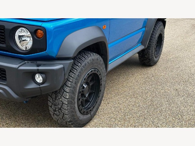

If we are all looking at the same car on autotrader then I agree that it looks to have caps on the front wheels the are far too small to allow for the vacuum hubs to be present. I definitely wouldn't put it past people to put aesthetics before practicalities and often safety, I have met members of the public before.
Replied by Lambert on topic Jimny LCV - Wheel/Tyre size question...
The wheels have caps over the hubs.Also I cannot see any front hubs (these come through the front wheels), it looks like these have been removed to fit the wheels, ask the seller how the front wheels engage or disengage? It might not have any front wheel drive or might be permanently locked, neither is desirable.
If the seller has messed with the 4WD just to fit these stupid alloys I would walk away.

I'm looking at this one. The wheels are the Gunner model from Black Rock.If we are all looking at the same car on autotrader then I agree that it looks to have caps on the front wheels the are far too small to allow for the vacuum hubs to be present.

The easy way to tell if the hubs are present is to start it up and let it idle, turn the air con & radio off, stop the salesman talking, open the drivers door and pull the transfer lever back into 4wd.
The hubs will go "clackclack" as they engage if they are present & working. (The 4wd light comes on after a couple of seconds)
Wait a few seconds to make sure there is plenty of vacuum in the tank and push the transfer into 2wd. The hubs will give a softer "clickclick" as they disengage.
I'd be more concerned about cracking my shins on that towbar, it would definitely have to go.
Replied by facade on topic Jimny LCV - Wheel/Tyre size question...
TBH, I'd expect wheels for a 4x4 to accommodate the front hubs, likely that cap is thin plastic. The wheels look to have more offset than standard too.

The rim edge certainly looks as if it is in line vertically with the wheel trim and that means it is approx. 25 mm further out than standard. I would suggest the car is fitted with wheel spacers and that would probably be enough to allow the fitting of those hub covers.

The problem is that without the seller taking the wheel off this is all speculation and as a buyer I would not be wanting to find out after I had bought the car. Caveat emptor and all that. Yes it might be fine but just as likely it might not especially with the oversized tyres and other stuff done to it it might all be correct ot it might all be held on with double sided tape. Other people's problems.
