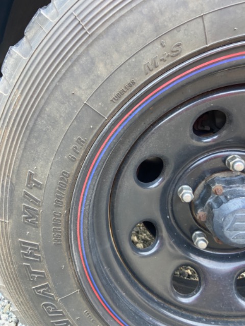

Writing from Vancouver, Canada. I've imported a 2006 JB43 and haven't had a chance to drive it much yet as it had some death wobble and haven't gotten it fixed and registered in Canada yet. It came with some 195r16 tires Toyo Tranpath M/T (it's got 16" steelies). What would the dimensions of this tire be? I'm used to 195/75 r16 not just the one number.

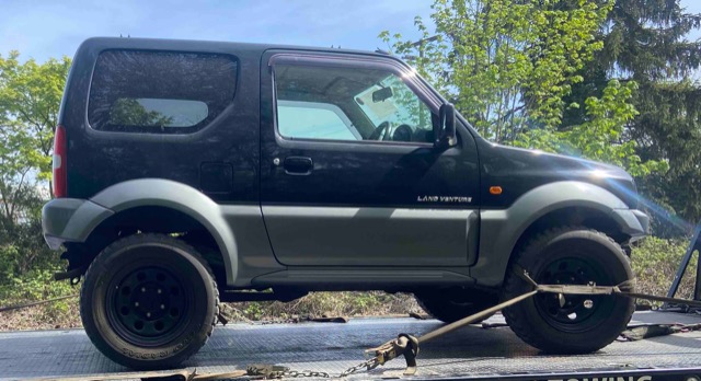

Also as you can see aftermarket front and rear bumpers with increased clearance. This isn't a daily driver, the plan is to use it more as a bush truck to reach remote camping and hiking spots around western Canada. I don't want to put a lot of money into upgrading it (re-gear, etc.) as that sort of defeats the purpose of this small, cheap vehicle. It currently has a 2" lift installed on it.
I've been reading lots of forums about tire size recommendations and it sounds like 215/75r15 (or the equivalent in 16") is recommended. Also I'm not sure about load index as I've usually driven bigger vehicles like a patrol (also imported form Japan) in the past. I'm looking at 215/70 R16 load 100 or 225/70 R16 load 103. Looking for feedback about drive ability on and off road as well as rubbing off-road with my current setup.

By convention, no profile number means 82%, although some manufacturers treat it as 80%. My first car, a Nissan Micra (March in the Americas) had 145R12 tyres.

This website is great for comparing tyre sizes
tiresize.com/tyre-size-calculator/
A standard Jimny on 15” rims will take 215/75 15” and with a lift will take a size (or two sizes) bigger.
Remember bigger tyre sizes will change the gearing, 215s are fine, but if you go much bigger you might need to change the gear ratio.
I would use the calculator to compare what you have at the moment with other popular sizes you are thinking about in 16” rims, then as a quick check compare the 16” rim to 15” rim, just to make sure you don’t go too big.
I did a quick comparison 215/75R15 is 27.7” diameter and 215/75R16 is 28.7” diameter, an extra inch, although it’s only 3.6% difference.
Another way of locking at it is 215/75R16 is about the same diameter as 235/75R15 although not as wide, so if others fit a 235/75 on 15” rims with a 2” lift then it won’t rub and always assuming they use standard gearing you will be OK.

Running 235/75r15s here on a 2 inch lift. Gearing is okay, its been used like this for several years now and no issues, but the arches are trimmed slightly to avoid rubbing when the tyres are stuffed up into the wheel wells on articulation.
