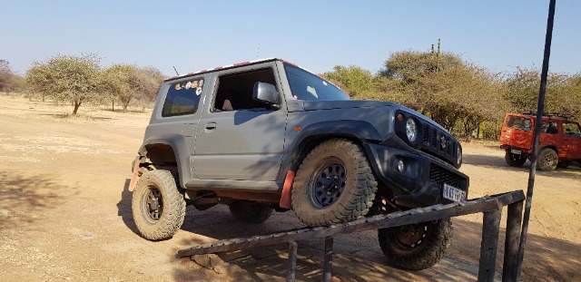

My Gen 4 with ant-roll bar removed, no measurements yet, but goes up that ramp about the same as the Gen 3 did...
