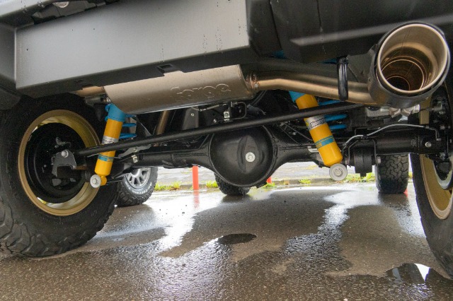

Good morning all.
Jimny Style have come up with a 40mm lift kit for the Gen.4. This kit uses H & R progressive springs with Bilstein shocks, all parts stated as being matched to improve on road performance.
I know that H & R and Bilstein are highly rated companies but has anyone got comments as to the kit itself?
Cheers
Roger

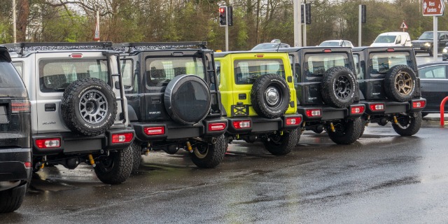

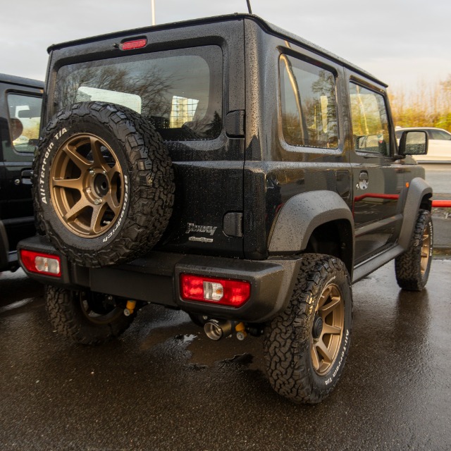

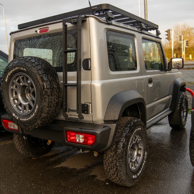

Whilst I sell the Pedders kit and have previously sold the Trailmaster kit and therefore cannot comment on the JimnyStyle kit, I do have some photos of it fitted.
In the lineup photo you can see the one car that is on standard suspension !
