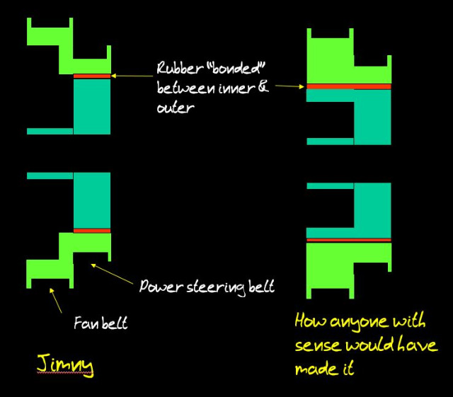

08 Mar 2024 09:26 #254901
by facade
Replied by facade on topic What's the normal lifespan of an alternator? (Gen 3)
The vibration was only slight, but I could feel it through the pedal.
Mine was manual, and it happened when pulling away just before it was time to change up.
The pulley is incredibly poorly designed, tensioning the alternator belt tries to rip the pulley apart, and is resisted by tensioning the power steering belt.
Grab the outer flange of the pulley and try and rip it off the car, if there is any movement whatsoever, it is time for a new one.
Here is my sketch of a section through the pulley to show what I mean.
