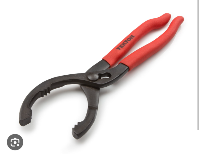

16 Feb 2024 17:39 #254382
by Busta
Replied by Busta on topic Oil filter removal.
