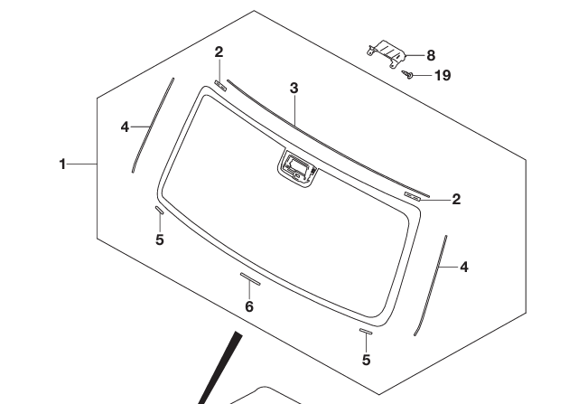

In Suzuki terms they are "Windshield Dams"
There is a upper dam and two side dams
They are installed on the glass before it is placed on the car and sit outside of the bonded area. Whilst they go most of the length of the top and sides they do not seem to join completely with each other at the sides
The installation instructions for them suggests they are attached (self adhesive??) to the windscreen before it is mounted. As you then install it you are supposed to ensure that they "fit to the roof panel and side panels" so they must have some sort of part in the body they clip or otherwise attach to.
Perhaps a key message in the workshop manual is "Do not apply excessive water pressure"
Parts 2 and 4 in the picture
