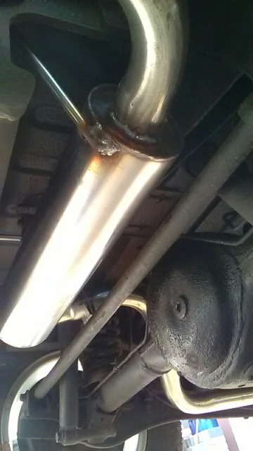

I agree, tidy that hole inspection port up and it's a handy addition.
As well as the top hanger rubber stretching over time, eventually the silencer top hanger bracket cracked, all this lowering the silencer onto my towbar with a consequential rattle, drove me mad!
The Suzuki silencer is a big heavy lump in a small space, so once cracked I had an exhaust company make me a smaller silencer....
Sorry not an off the shelf item, but also not that expensive considering it was hand made and has a lifetime warranty.
Like all modifications the Jimny was instantly 100mph faster, simply as it removed 200kg of dead weight. But more importantly that rear end rattle had gone, so now I could enjoy all the other front end rattles as before
