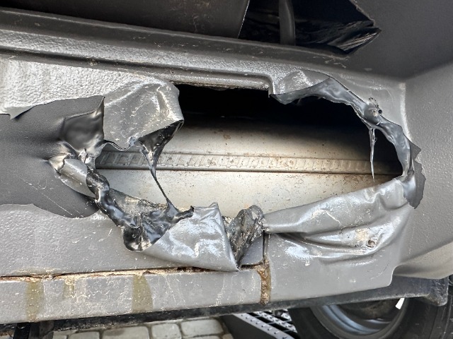

Today I had some spare time and looked at the way to get to the exhaust hanger above the muffler. I looked from all angles and then I spotted something. Behind the number plate some paint started to peel off. i took the plate of and found that the plastic had melted:-) I can only image that the rubbers were so worn that during steep inclines the muffler touched the plastic.
anyways, it was a nice and big enough opening to get to the rubber. I managed to squeeze a new rubber on, also installed new rubbers on the other hangers. it all is hanging properly now, without metal tie wraps.
i now need to look for a piece of thin sheet metal or so to cover the hole;-)
