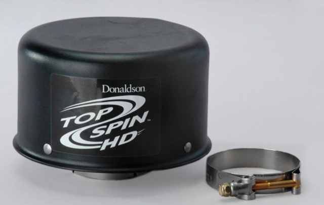

I would tend to agree. Although for really dusty environments you can run a different heads that will prevent more dust ingress. But maybe at a cost of air flow.
I believe in places like Oz they also sell snorkel socks for dusty conditions.
