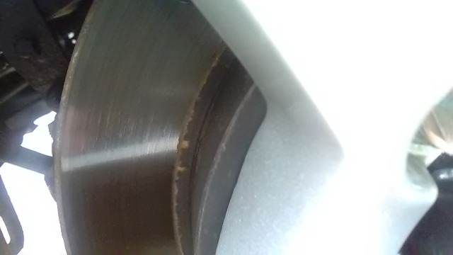

EBC green pads and disks here also, well worth the extra money in my opinion. I could feel the extra "bite" and Lambert has seen confirmation on the brake tester. I had Pagid prior to these and they scored up and started to pulse way before they had worn down. The EBC disks are visibly less scored when used in conjunction with EBC pads.
Been on for several thousand now and not scoring up (or falling apart). Also considerably less brake dust on the wheels. I've only ever fitted EBC to my motorcycles and they get pushed a lot harder than the Jimny, wouldn't fit anything else.
