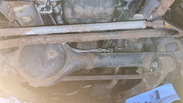

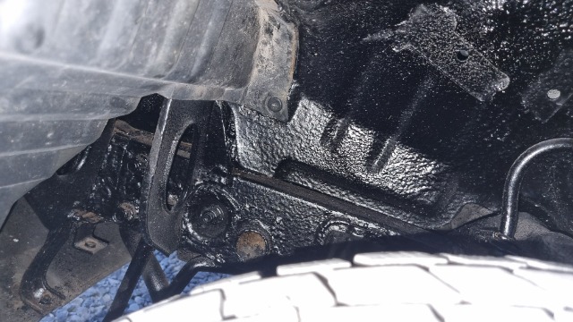

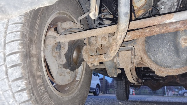

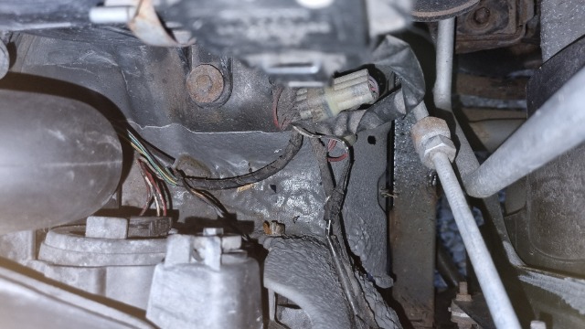

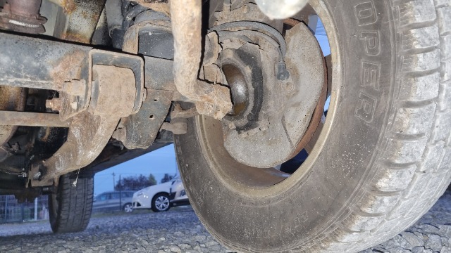

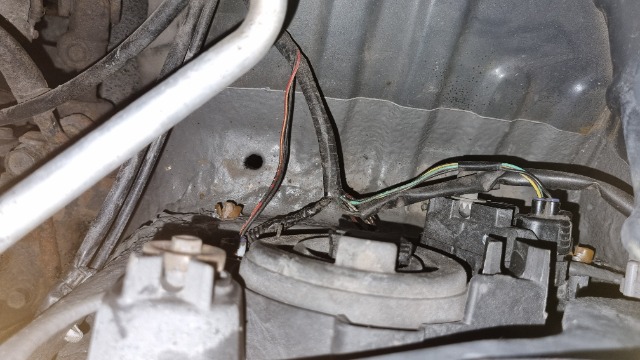

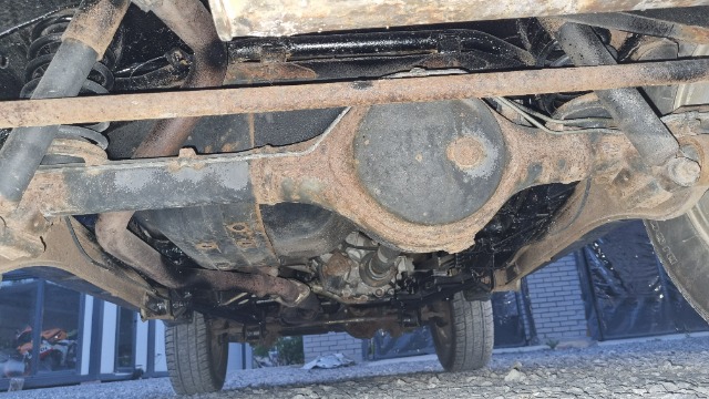

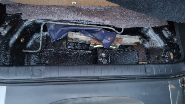

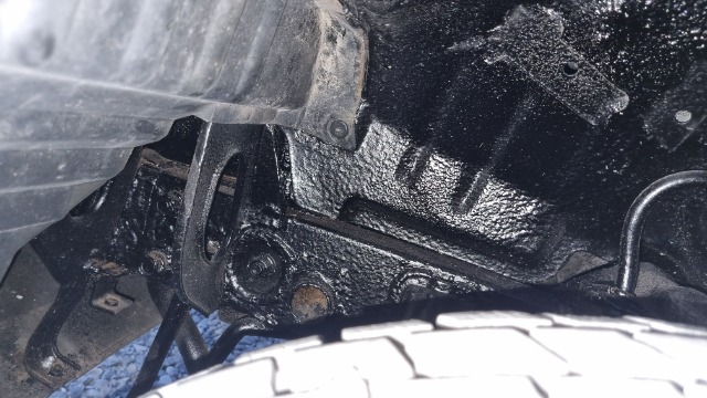

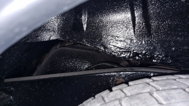

Looks ok to me, better fixed than not. A little knock or a magnet may reveal if anything else than metal is under the nice black something. Not too alarming sweating at the swivels either.
Rust allways comes back if left wet and dirty. Time only can tell if the base layer and work done before coating was OK, but looks good.
Rods and shafts should be treated some time soon. A wirebrush and any rust preventive paint is way better than nothing.
The following user(s) said Thank You: jamesdin
- Thank you received: 706
3 years 1 month ago #250947
Replied by jackonlyjack on topic Fixed car body
Personally I wouldn't buy unless they have pictures of work done........ hiding everything under the underseal
