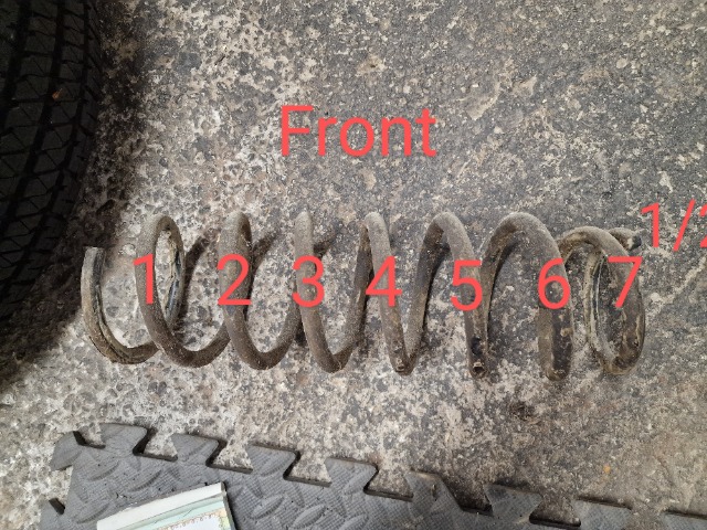

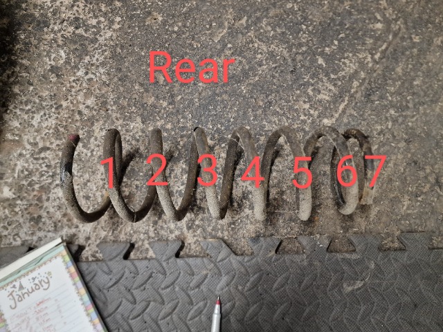

05 Jul 2023 19:23 - 05 Jul 2023 19:35 #249738
Replied by Soeley on topic Road spring compatibility
The results are in:
FRONT SPRING
Length = 350mm
Inside Dia = 87mm
Outside Dia = 115mm
Coil Wire Dia = 11mm
No of Coils = 7.5
REAR SPRING
Length = 315mm / 300mm
Inside Dia = 87mm
Outside Dia = 109mm
Coil Wire Dia = 11mmNo of Coils = 7
I wasn't sure on what the international standard of Coil measuring is. So I've added picture's to avoid any confusion
