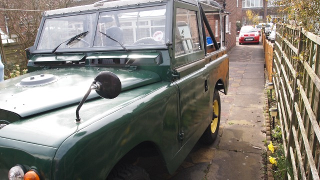

Look at what you have available and factoring in cost I would use a roller.
It has the advantage you can easily do a panel at a time with minimal masking, no over spray to contend with.
Very little waste and no cleaning up, throw the cheap rollers away rather than trying to clean up etc.
Light sand to key the surface then throw on the top coat, 1k poly is very forgiving if it's applied to old paint. Any metal / rust will need priming etc.
Apply on cool days with little wind, the trick is you don't want it to dry quickly, this allows time for it it level out.
If you go this route talk to your paint supplier and tell them you are going to apply with a brush / roller, they will mix the paint for this application and extend its drying time.
Here is the finish, please keep in mind there's no attempt to cover up the 60 years of dents and bumps, just to turn it green.
I'll add it took about 3/4 ltr of paint to do this inside and out.
