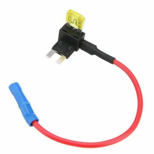

You can easily extend the wires or look at mounting it near the fuse box in the driver's footwell. This also provides a convenient location to pick up a permanent 12v supply using a spur fuse adapter. They look like this and plug into the fuse box.
