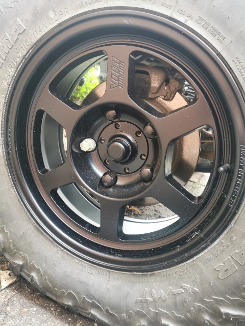

I've been on 16's for years
Ran with 225 75 16. 195 80 16
Now on 7.50 16
Just fitted these wheels made a big difference from the steel's

09 May 2023 19:24 #249056 by jackonlyjack
Replied by jackonlyjack on topic Gen 4 16” rims
My alloys are 6kg lighter than the steel's
And this weight loss is so noticeable
In acceleration steering feels lighter braking better
Also my intermittent slight wobble has gone
But take into account my tyres stand 32" tall
And are wheel/tyre 27kg each
