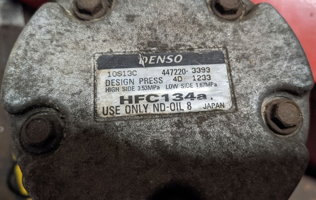

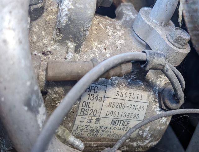

Not sure if this helps but I have 2 Jimnys with different air con compressors here.
First is on an '00 G series Jimny, no obvious manufacturer name but it has the following numbers on the compressor: SS07LT1 95200-77GAO 0001138595
Second is an '03 pre-vvt M series which has a Denso unit with: 10S13C 447-220- 3393 4D1233
