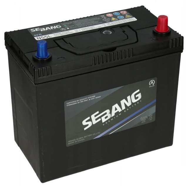

Thank you all! I finally debugged the circuitry. I had to contact the manufacturer and service center explained how the alarm's power draw changes after locking the car. 200mA was only for the first few minutes. Jimny was taking ~55mA when locked without alarm connected. With alarm on I had to wait ~20 minutes before it went to sleep and back to 50-60mA. However every few minutes it spikes to around 80mA for a couple of seconds.
Anyway I have to change the battery as it went dead during winter and desulfation didn't help much. I was misled as the KONNWEI KW510 battery tester showed GOOD status for the battery health. It reached rated CCA of 370A when was fully charged but dropped to ~260A at 12.3V.

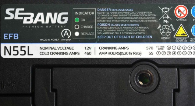

After considering all pros and cons I chose EFB battery which has 55Ah (+10Ah vs stock) and has almost same size as the original one. The model is Sebang EFB N55L 55Ah (L/W/H [mm]: 235 / 125 / 190).
