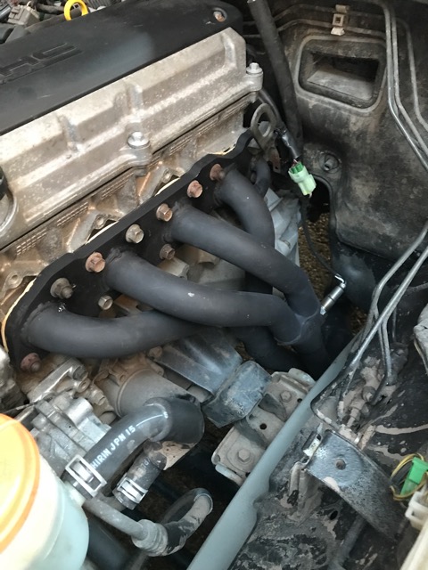

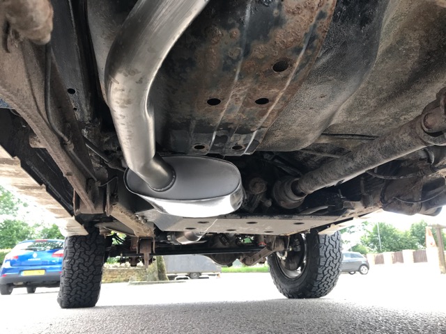

30 Sep 2022 08:03 #245227
by sniper
Replied by sniper on topic Aftermarket headers
Cracking piece of kit, fitted mine on a 1300 with a stainless 2" sports cat (200cpa) single box system from Tony Banks in Leeds. Made a big difference on the 1300 and now copes with the 1600 fine. Lots more torque but once you get a standalone and get the 1600 mapped, much more early and mid range grunt.
Sounds ok and no problems with emissions on the standard ecu or the standalone....
sniper
sniper
