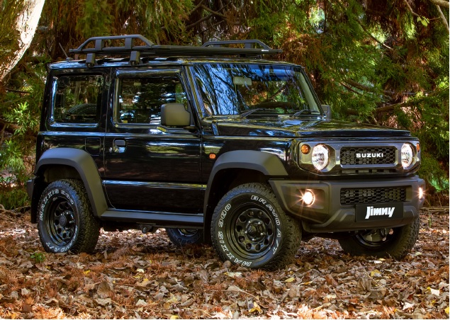

19 Aug 2022 19:43 - 19 Aug 2022 19:45 #244628
by fordem
This is the special edition "Jimny Safari", running 215/75R15 on stock streel rims. The tires are flush with the flares, the steel wheels are not.
Replied by fordem on topic Wheel spacers gen4
Thanks fordem, i didn't realise the wheels (steels) would be flush with the 215/75's - i was just watching a Youtube vid and this guy added spacers so i just assumed i needed them too lol
Last edit: 19 Aug 2022 19:45 by fordem. Reason: Clarification.
The following user(s) said Thank You: Phooey

21 Aug 2022 07:59 #244663
by Phooey
Replied by Phooey on topic Wheel spacers gen4
Thanks, that looks bloody fantastic!
