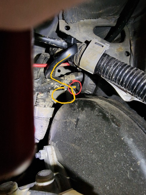

I'd not even spotted that little grommet up near the top.
I poked mine through here and cable tied it to the main loom with a drip loop to allow any water to run away from the grommet.

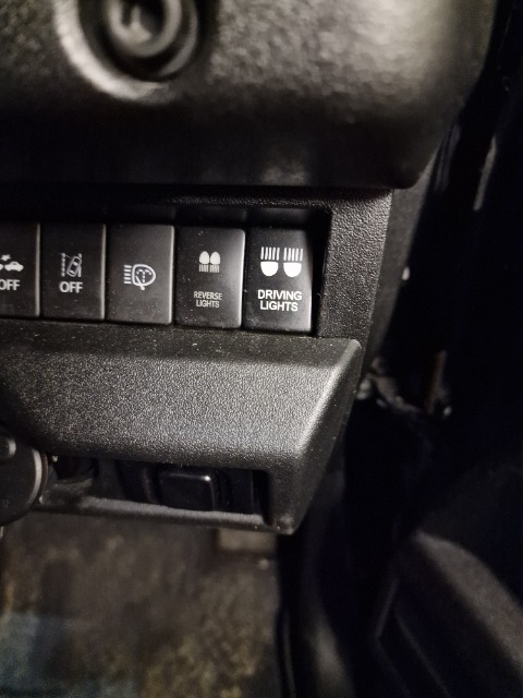

And this is the switch.
